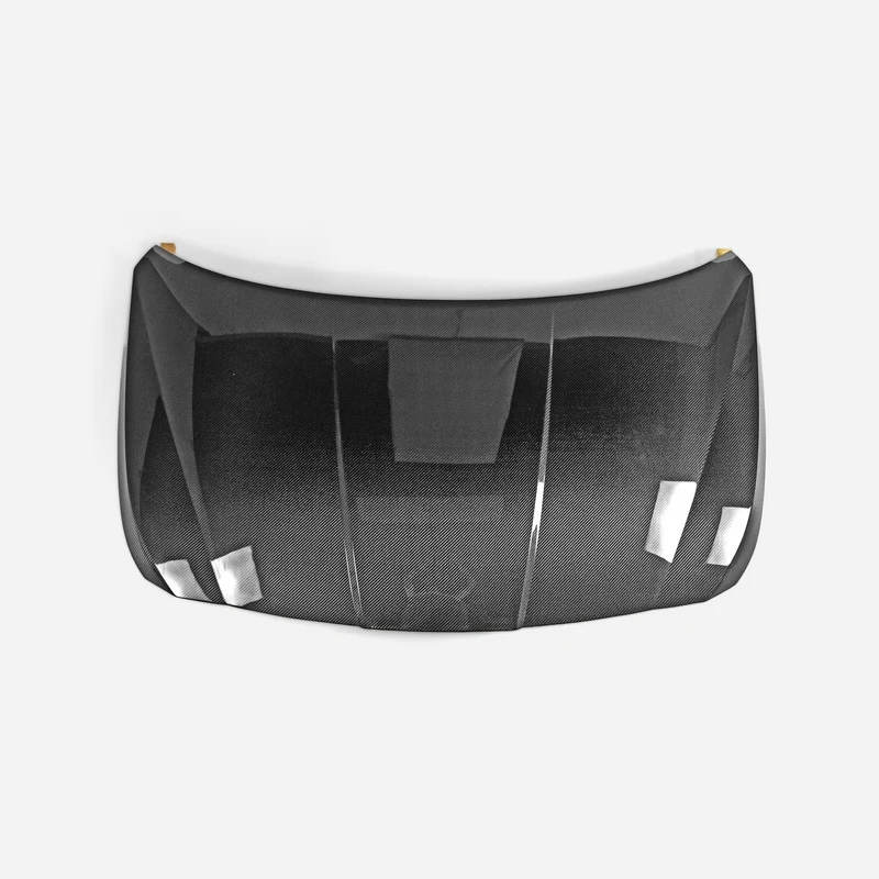

This second is three options of carbon fibre bonnet - one with a single central vent, one with dual rows of side vents and one with no vents (like the original).

I hate carbon bonnets.... but those dual side vents are so good looking... i know painting carbon is a thing but i cant justify that cost.
Edit: Of course the carbon will blend well with your colour, my blue not so much
