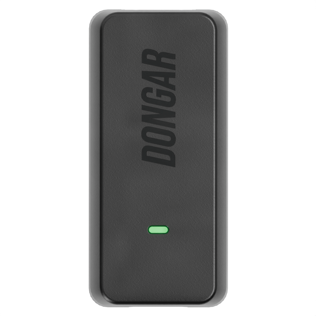

For the front camera, there a 10 pin connector from Dongar Technologies that allows a direct connection without tapping the fuse panel and running wires to it.👍🇺🇸

DONGAR TECH;
Doesn’t need a fuse connection.👍🇺🇸
