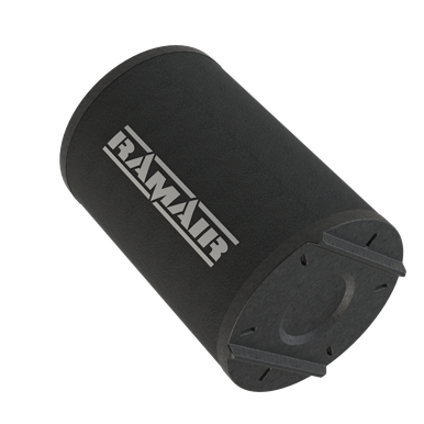

Just noticed that Ramair now have a filter available. Looking at the end cap it seems like they've come up with a way of locating it nicely.
