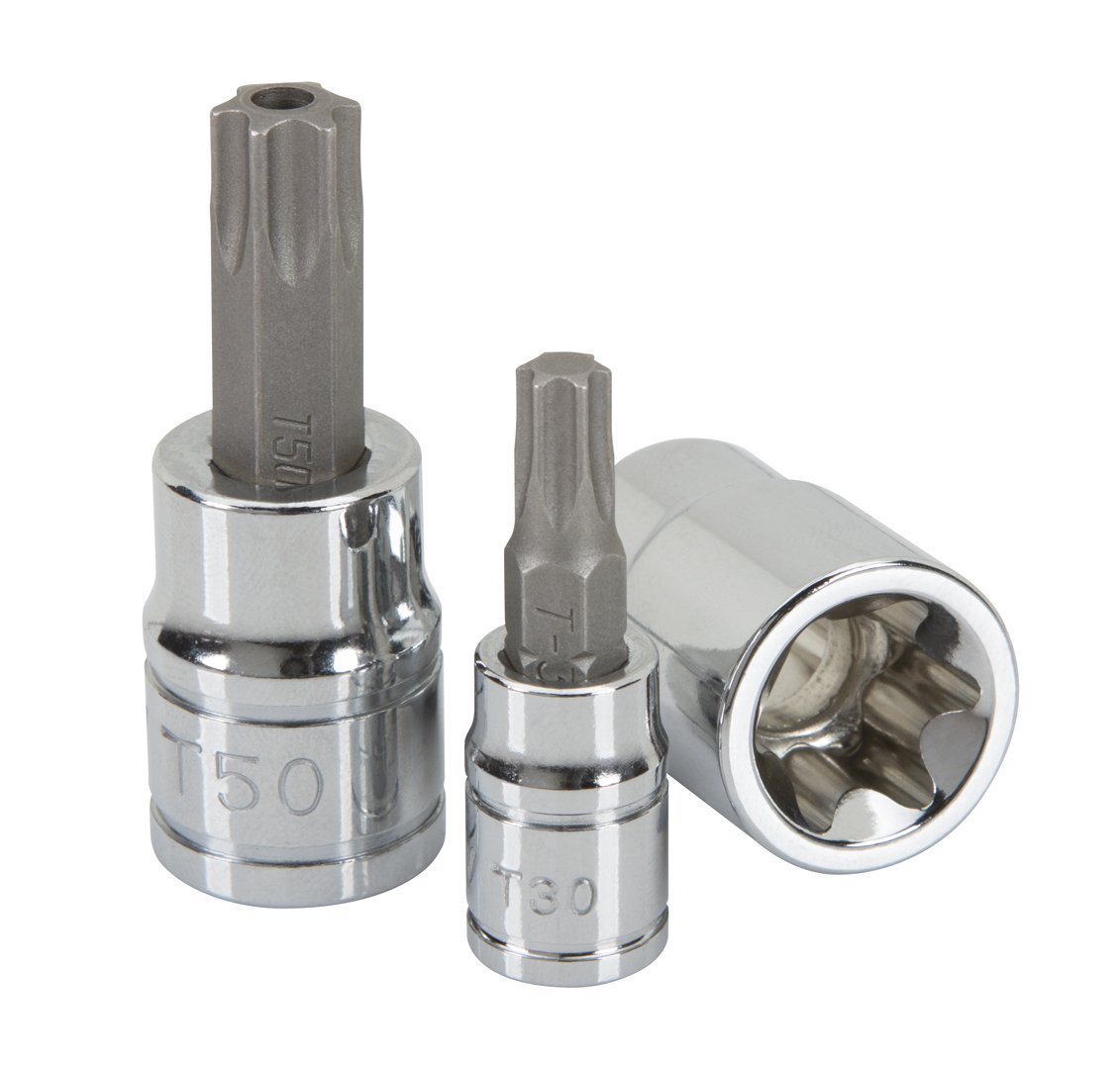

@NULLOBANDITO use a star bit that fits tightly in the allen screw. You may have to tap it in but you'll be able to extract them. If the allen screws were soft enough it strip, they will be soft enough to allow a star bit to bite into the socket.
Then go to a hardware and purchase some that are stronger using the originals as your size and pattern.
