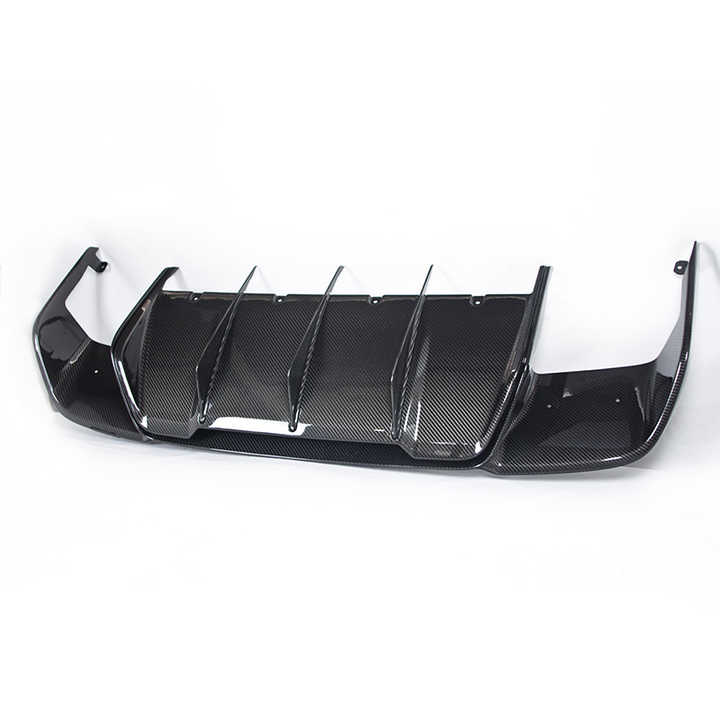

What‘s CFPR (carbon fibre print?) please? Also, are they not the ones I’ve seen on AliExpress then - they are CF pattern printed onto ABS?
Actually I did mean printed. You can buy ABS sheet with a CF pattern printed on it (I’ve used it). One side is high gloss with the silver CF printing. To be honest CFPR means that short strands of CF are introduced into the plastic to strengthen it - but it doesn’t give any CF weave effect because there’s no woven fibre used.
https://www.corrosionpedia.com/10-t...fiber-reinforced-polymer-and-corrosion/2/6791
This is just a few examples of automotive CFPR.
And it’s use, just like the mirror caps I installed. Which come is several different weaves 2x2 twill to forged patterns.
These are all CFPR parts.
I used to teach material technology. Do you perhaps have a link to the caps?
Looks like we have been talking cross purposes then as that is ‘real’ carbon fibre and the only plastic involved is the resin. This is also the first time I’ve seen this particular mirror shape done in CF. I’ve seen a lot of covers of this shape but, until now, they have all been ABS with an applied (printed or hydro dip) CF pattern.

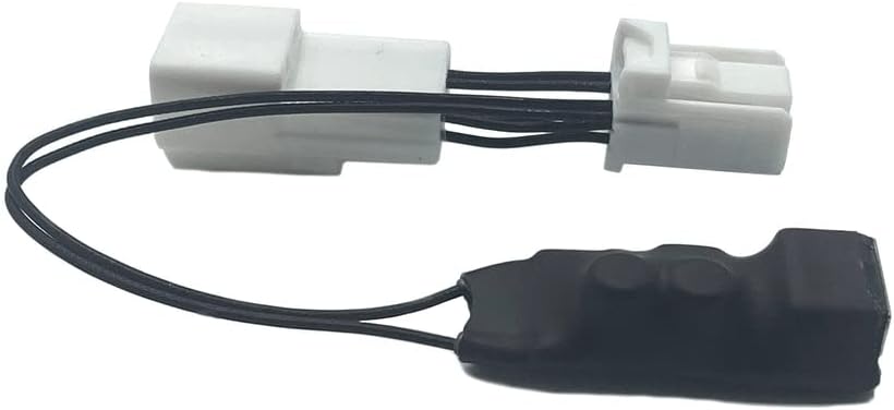

Added a new Dongar Technology Dash Camera wiring kit to the mix;
Easy 15. Invite installation, no splicing micro II fuse taps, just plug and go.
No more cluttering up the fuse panel for power tap.
