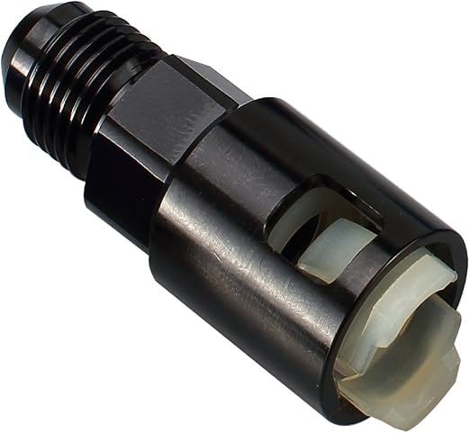

Short length of OD 5/8" hose -ID 1/2" with this finisher at the bottom of the nozzle then couple to this with the female hose. If I find anything else I'll post it.
Try here for fittings;
AC PERFORMANCE Black Aluminum 3/8'' 3/8 inch Female EFI Push On Quick Connect Adaptor to -8 AN AN8 Fuel Line/Rail Hose Fitting;
Can't remember what the nozzle size is at the moment but one of these with the correct push on nozzle size and the AN8 male adaptor will work also. If it's a 3/8" nozzle this will work These are for fuel injection, so they can more than handle the crankcase pressure and it will give you the additional clearance I believe, with the female connector.

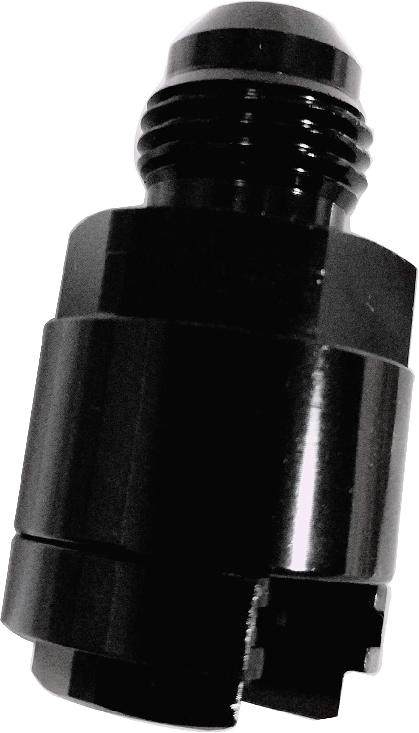

This might work also in the right nozzle size
If I find more I'll post them. Amazon.com
