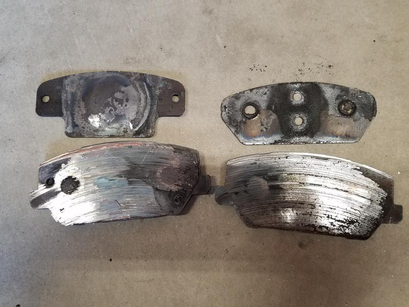

At my 3rd track event, I checked the pads and there was around 75%. So I should be good right? No, I melted the pads!

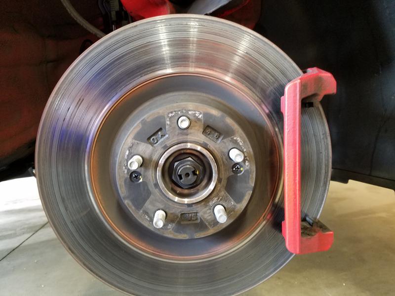

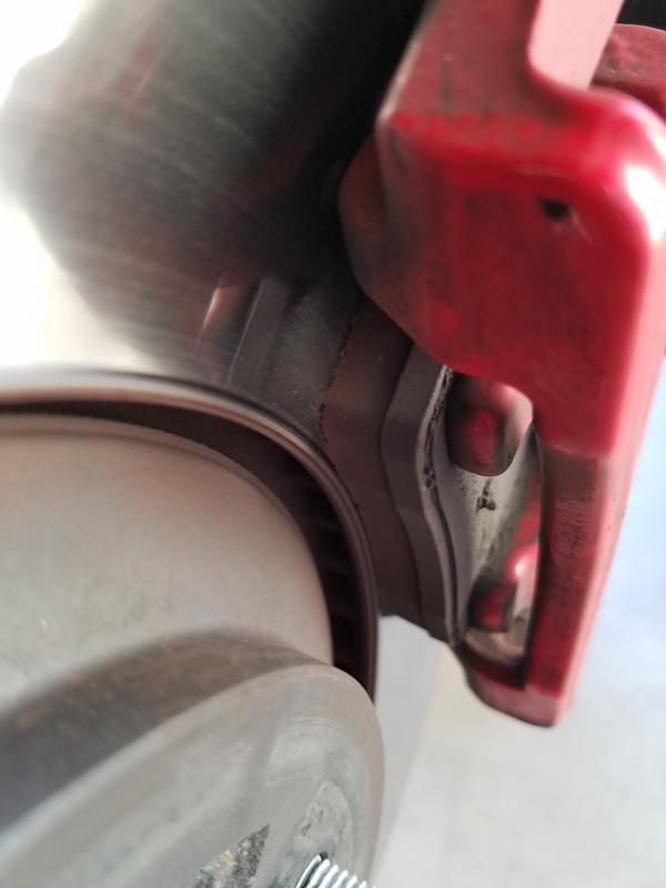

The pistons still look OK:
The rears look good:
I experienced brake fade in the 5th 20 min session, so I came in to check. Thinking back, I did notice a LOT more dust than normal when checking pressures. I would get a poof of brake dust in the air after inserting my tire pressure gauge and there was a little pile of brake dust on the bottom of the wheels. I guess that is a sign!
This was the same track as the 2nd event but in reverse. The difference was we went out on the hour. So 40 mins of down time, the brakes are probably not completely cooled down. Also, we only got 1/2 lap cool down. Next time that happens, I am going to drive down the road a couple of miles to cool the brakes down more.
Obviously, I do not recommend these pads for track use. I have an event on Nov 23, so I need new rotors and pads. I'm going to put in some Motul 600 brake fluid as well.
