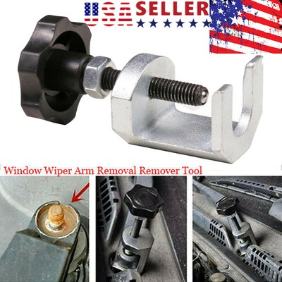

I can't get my windscreen wipers off, so I can remove the windscreen cowl and get to the sound generator - anyone know the best removal tool for the job? Thanks
I removed my plug by poking a thin allen key (can use screwdriver, etc) through 1 of the holes in the cowling vent above the plug and managed to lift the tab and slide the plug out in a matter of seconds.
I decided several weeks later to wrap the end of the plug so it's watertight (probably doesn't need doing) so bought 2 different "windscreen wiper removal tools" off ebay for when i had time to do it properly.
I removed the 4 fixing clips and the rubber seal and noticed the plug was almost touching the front of the cowling and so lifted the front of the panel just enough to get my fingers in to pull the plug out far enough to wrap
£10 wasted on the removal tools as i didn't need them but saved 1/2 hour without having to remove the wipers and panel 👍
Reactions: Steve RBF
Put them in the upright position, turn ignition on then off and within a few seconds push down on the wiper switch, the arms will go vertical, then wiggle them off from there, you can apply a lot more leverage, especially if you alternate by hingeing them out, wiggle hard then back straight and wiggle. They will come off.
