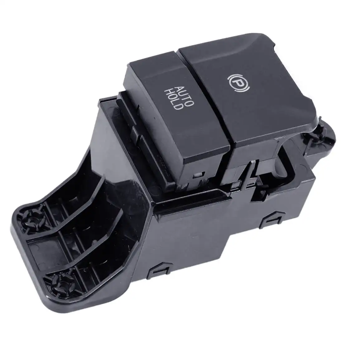

Thanks to OP, and the video, I decided to fix it myself. So I ordered this part from AliExpress, about 25aud delivered.
The part DOES work. But it is shaped for LHD, not RHD in Australia. Yes, if you can believe it, they made a slightly different fitting part just because of that.
In any case, with some small modifications, you can make it fit into the console and it works just fine. The switch housing has 3 screw mounting points. 2 at the back, 1 at the front. The hole for the front screw just needs to be drilled out a bit towards the 4 o'clock position. This gives it a bit of sideways movement so that the switch action can clear the edges of where it mounts.
You also need to do some light filing on the edge of the console where the switch "pulls" up into the console. Take off a mm or 2, and it clears just fine.
All up, the switch once in place looks only a little odd, slightly off angle. Noticeable when you look for it, otherwise who cares. And it saved me 525aud.

As you pointed out, the part was a LHD which did cause an issue. I couldn't find an RHD anywhere online that wasn't stupidly expensive. I didn't need to drill out the mounting hole though, I just put some sandpaper on a flat surface and rubbed the side of the switch on it until it would operate in the console without it catching. It didn't take much effort.
It doesn't sit flush but you don't notice it at all unless you specifically look at it. The replacement has a proper click to it so I don't think it has the same design flaw as the OEM switch Hyundai are asking $500 for. Their replacement part costs are insane. They wanted $4000 to replace the headlights..... I fixed them with $10 of supplies from Bunnings.
