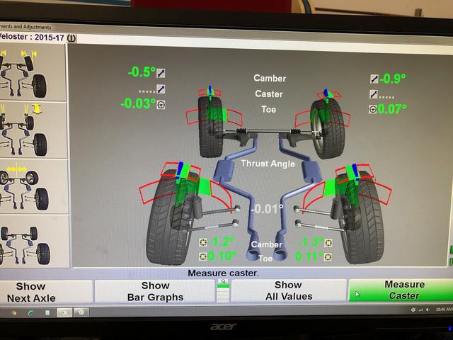

Post your alignment setting in this thread.
Stock Alignment (I had 1100 miles on the car)

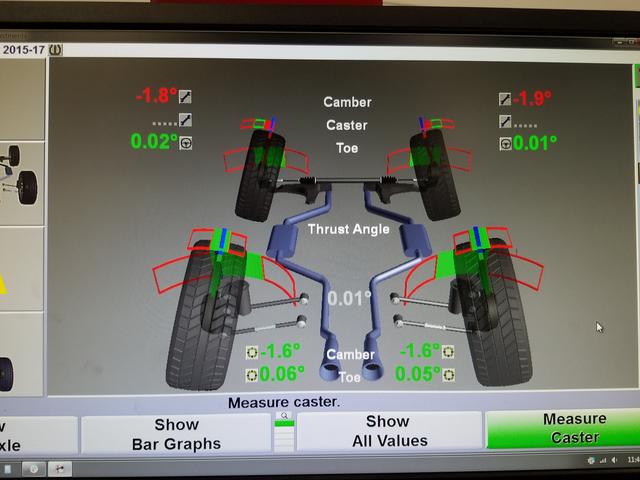

Installed these Camber Bolts and went in for an alignment:
https://www.whiteline.com.au/product_detail4.php?part_number=KCA414
The difference is huge. I took it on my regular canyon runs and the turn in and sweepers are so much better. I was getting tossed around in my seat a lot more...
How has your tire wear been with this setup? Do you rotate often? What tires are you running?
6,385
4,685
Wear with -1.9 degrees camber would be negligible over the OEM setting. When you push it to -2.5 or 3.0 is where you'll see a change in wear characteristics. This amount of camber is not needed on the street, only the track. Negative 1.9-2.0 is more than sufficient for street use. :)
